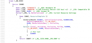

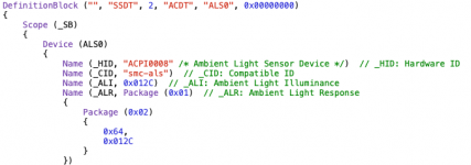

Have you tried editing the SSDT-ALSO.aml table so it looks for the ambient light device your DSDT?
The Standard SSDT-ALSO.aml table looks to attach to this data/device:
Screenshot 2023-08-09 at 16.57.37.png,
Your DSDT.aml names the ambient light device as this:
If you replace the following two entries n the SSDT-ALSO.aml table will the SSDT work for your laptop?:
Replace Name {_HID, "ACPI0008" with Name {_HID, "ITE8353"
and
Replace Name {_CID, "smc-als" with Name {_CID "PNP0C50"
A copy of the edited SSDT-ALSO.aml table, renamed as SSDT-ALSD.aml is attached if you want to try using this table in place of your current ALSO table. This edit may not work, but should be worth a try.

Thanks for your help. I tried your solution but my ALS still won't work.
Sorry, not sure what else you could try.
