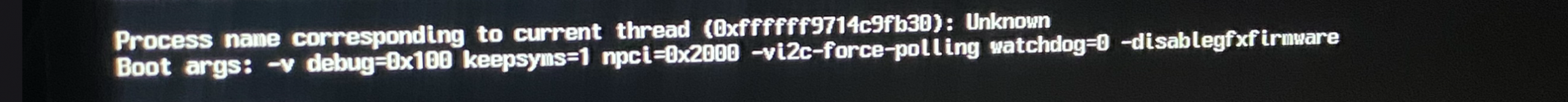

Trying to get hackintosh Ventura 13 working, got past an EXITBS error but now I'm stuck on "invalid frame pointer". Tried some fixes from the Dortania guide but nothing seems to work. Help is much appreciated! Specs are: Lenovo Ideapad 3 slim 15abr8, Ryzen 7 7730U, iGPU, 16GB Ram
You need to change Misc > Security > SecureBootModel from 'Default' to 'Disabled'.
You shouldn't be using any DeviceProperties when using NootedRed.kext, they can cause unnecessary clashes/KP's.
Add the property as a boot argument, i.e. alcid=100 instead of as a DeviceProperty.
You may need to disable NootedRed.kext during the installation of macOS Ventura, as it is known to prevent the installation from completing.
Changed SecureBootModel and used alcid=100 instead of deviceproperty and even tried disabling nootedred but still getting the same error, anything else I could try?

Video it booting. That image doesn't show the cause above. It'll help in diagnosing the issue.
The image above doesn’t show what you said you had done in respect of the alcid=100 boot argument.
alcid=100 isn’t present in your setup, according to the image above.
Also why are you using -disablegfxfirmware boot argument?
If you are using the AMD Intergrated GPU that boot argument will not help. When I said you needed to disable NootedRed.kext during the installation, I meant for you to use the disable option in the config.plist.
Here's a video of it booting. My bad @Edhawk that was an image from before i made the modifications. This one is with the current config with your suggestions. Still not booting, if there's anything else I can provide that'll help diagnose lmk.
