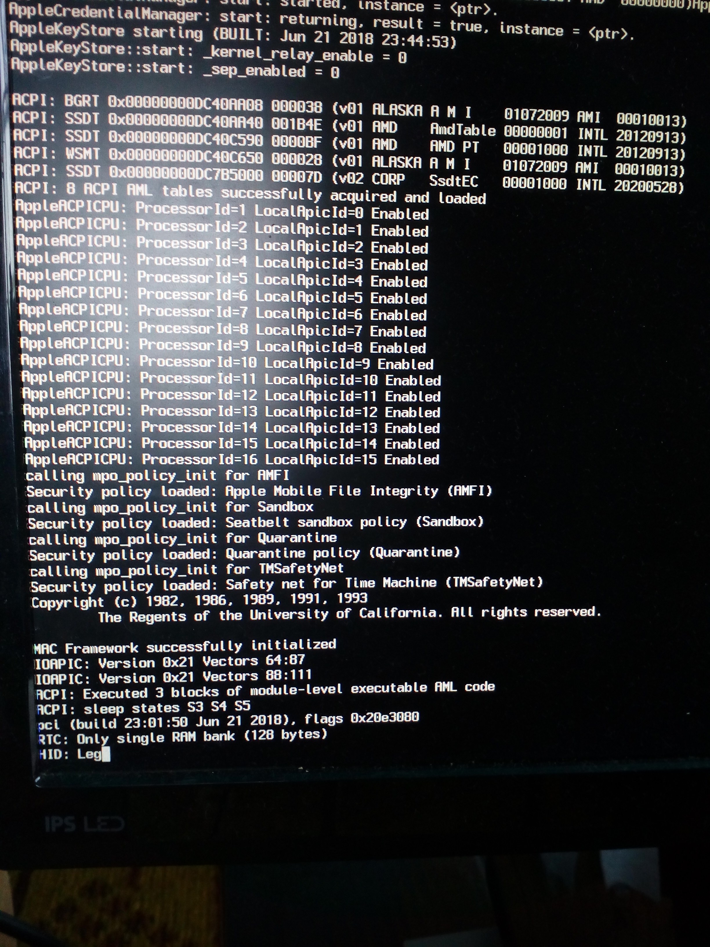

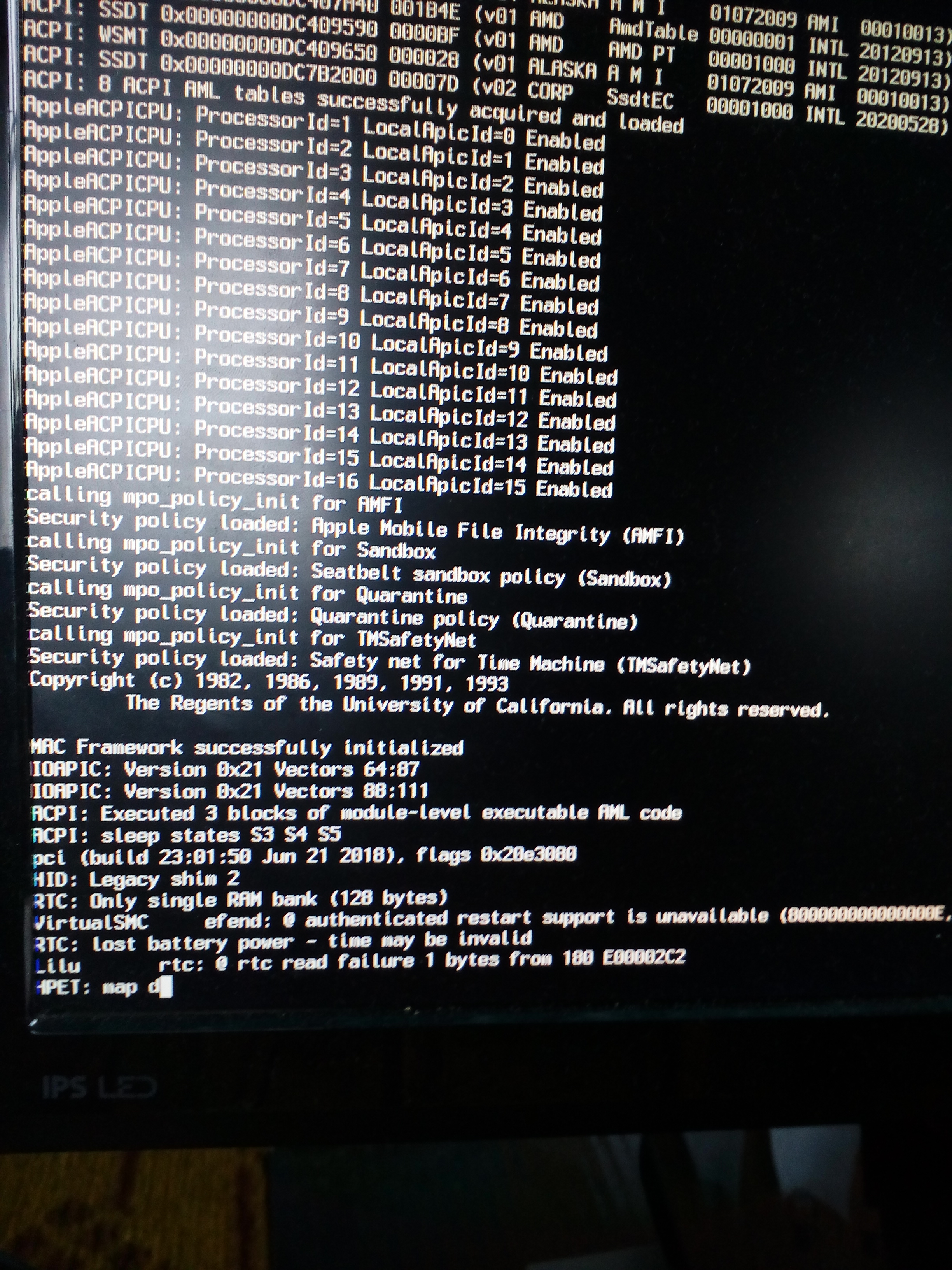

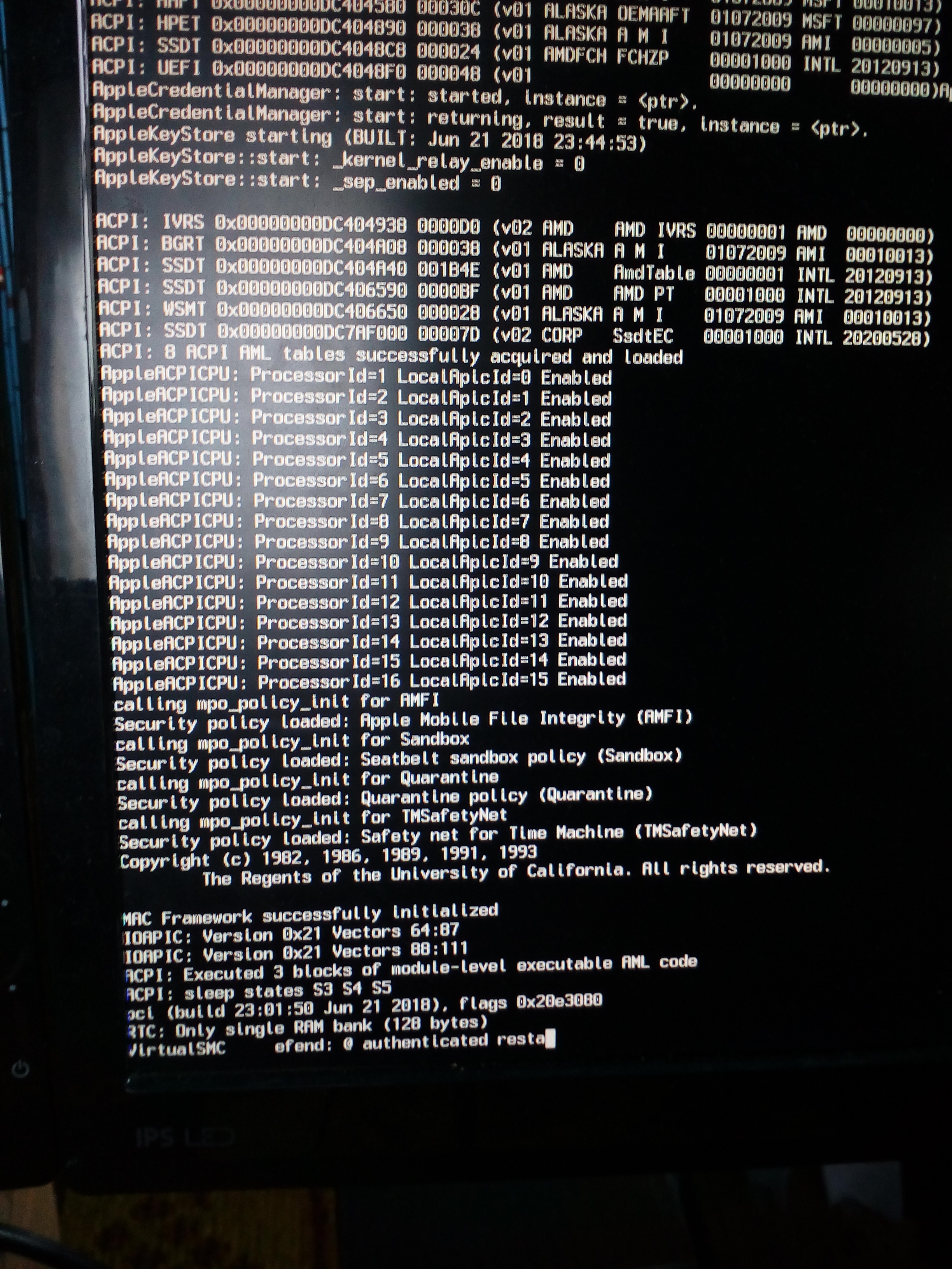

Yeah, now the installation goes much further, but anyway stops. Tried it 3 times. Here is 3 reports.
