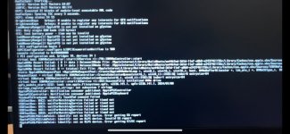

Now I get these errors, and can't even reach the installer anymore:
USBToolBox: XHC2: waitForMatchingService failed or timed out
USBToolBox: XHC3: waitForMatchingService failed or timed out
USBToolBox: XHC4: waitForMatchingService failed or timed out
USBToolBox: XHC1: waitForMatchingService failed or timed out
USBToolBox: XHC0: waitForMatchingService failed or timed out
ApplePS2ALPSGlidePoint: Identify: not an ALPS device. Error getting E6 report
ApplePS2ALPSGlidePoint: Identify: not an ALPS device. Invalid E6 report
ApplePS2ALPSGlidePoint: Identify: not an ALPS device. Error getting E7/EC report
stuck.

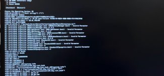

Also I saw the following during Init (This wont happen with the EFI I posted):
Prelinked Injection of some Kexts (SMCBatteryManager, SMCLightSensor, SMCProcessorAMD, VoodooI2C, VoodooIC2HID, VoodooIC2Synaptics) - Invalid Parameter.
I attached some photos of my screen and the updated EFI Folder.
