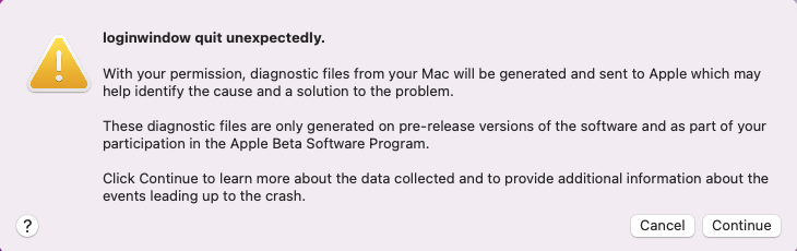

My FX-6300 hackintosh had this problem:
When I try to wake it up always got this error as posted picture or black screen.
No such an issue at Big Sur or Catalina.
OC 0.7.8's config.plist posted too.
