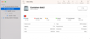

Here is a view of my macOS drive (1TB WD SN770) in Disk Utility it shows the size and number of partitions created on the drive, all done automatically from the above steps.
Screenshot 2023-10-25 at 19.25.55.png Disk Utility view of main APFS Container with 5 volumes/partitions shown.

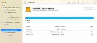

No, it is very simple when you use a separate drive for macOS. Which Apple expect to be the case in their systems.
When you get to the Apple installation Wizard, all you need to do is this:

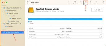

  1. Open Disk Utility.
  2. Select the drive you plan to install macOS on, in the righthand navigation bar.

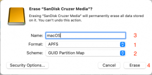

    • Screenshot 2023-10-28 at 22.58.54.png Disk Utility - USB pen drive used as drive to be erased in this example
  3. Select 'Erase' from the top row of icons,
    1. Select Format = APFS
    2. Select Scheme= GUID Partition Map
    3. Enter a name for your drive, i.e. 'macOS' or something similar.
    4. Select 'Erase' button
      • Screenshot 2023-10-28 at 22.59.19.png Erase selection dialog box with options numbered to match information listed above.
  4. When you select the 'Erase' button the drive will be erased and reformatted to the settings specified.
    1. So make sure you selected the correct drive as everything will be lost on the drive.
    2. Screenshot 2023-10-28 at 23.11.47.png Erase process completed,
  5. Select 'Done' button.
  6. Exit Disk Utility once the process has completed.
    1. Screenshot 2023-10-28 at 23.12.16.png Newly Erased/formatted drive now shows as APFS formatted drive.
Now when you start the Installation process all you need do is select the drive named 'macOS', or whatever you named your drive, as the location for your macOS installation. Simple!

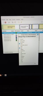

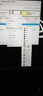

n case it helps, I explain what I do...
1.- I always have a live usb with linux mint
2.- With gparted I make the partitions I need, one of 512 on fat 32 and I name it EFI , and in the menaje flags I point to boot and esp
3.- then the partition where I will install the OS, I name it as MacintoshHD and format it as +hfs
4..- and that's it. When I start the installer, with the disk utility I look for the MacintoshHD partition and I click delete with APFS (or whatever), I exit, and I start the installation.
5..- At the end of the installation, if I have not yet copied EFI to the corresponding partition, I open with MINT and copy the boot folder (EFI)
