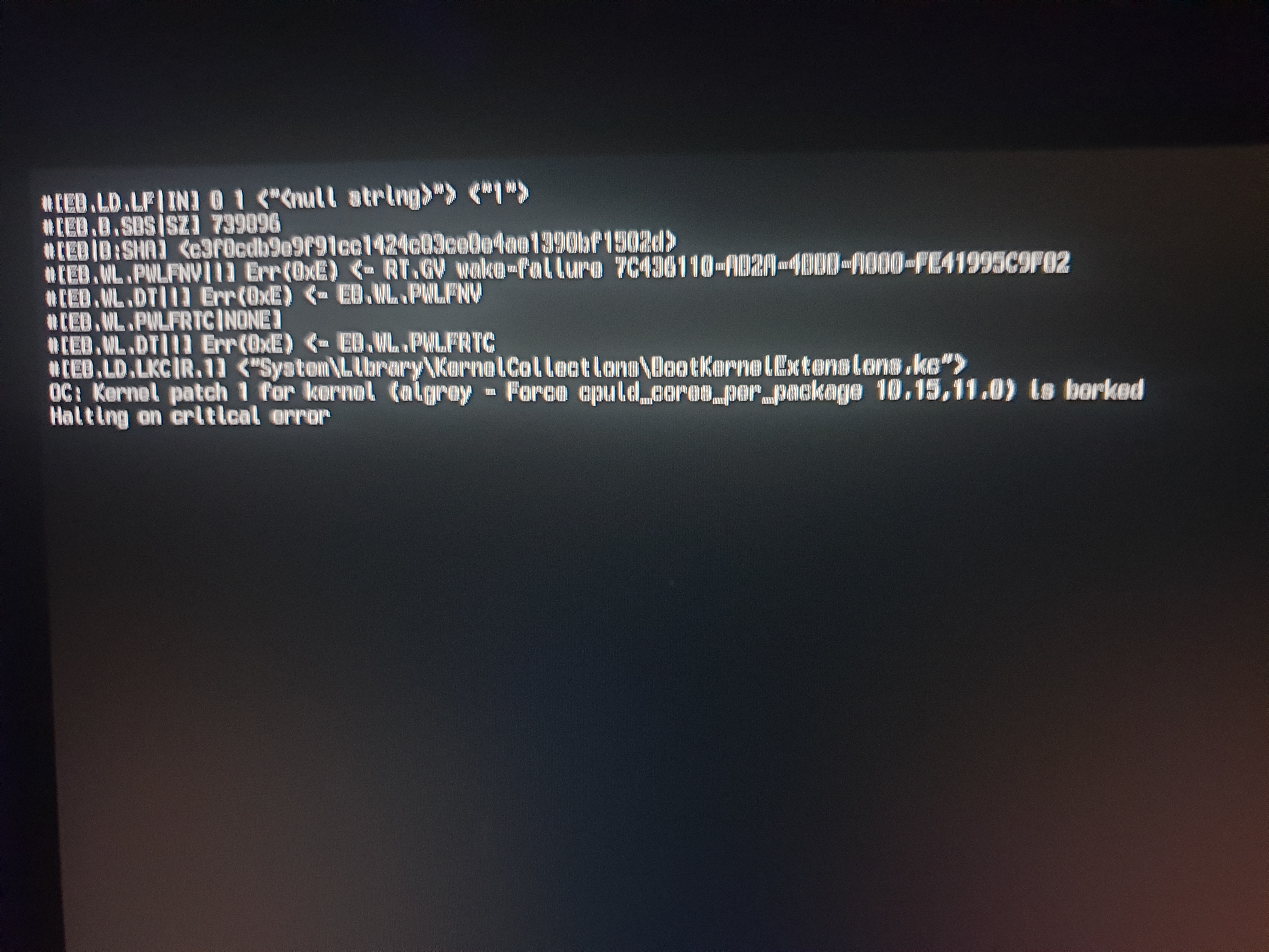

Hi, having big issues with AMD_Vanilla. Can someone please help?
inevere
Nov 23, 2021
Amd Ryzen7 3700x
Hi, I've been trying for the majority of the last 24 hours to get Big Sur working. Every time, it's been Patch 1 of AMD-Vanilla OC. I've reinstalled, re-downloaded, and checked the patch line for line and there is no difference. I've also made sure that the Replace value has been correct. By all means, in my understanding, this shouldn't be an issue I'm facing. Anyone have a solution?
Attached is the log.

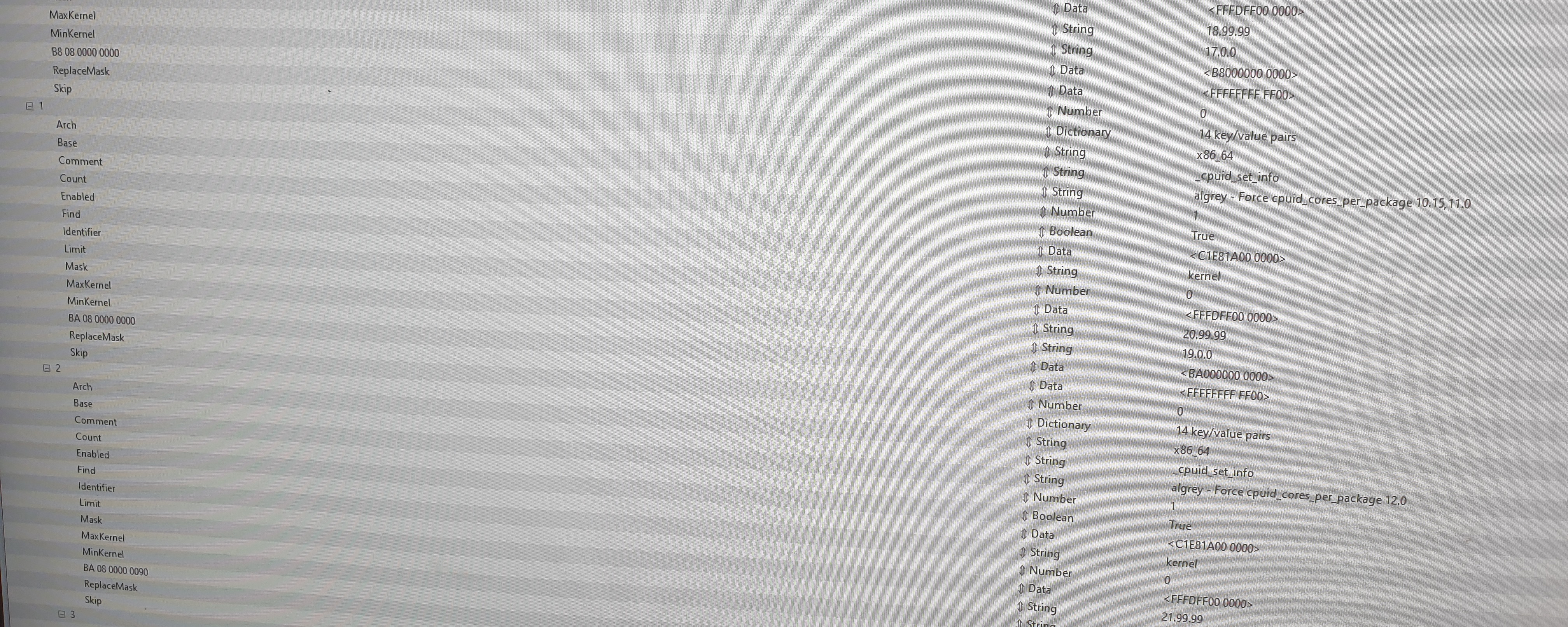

Edit: Added 2 more images of error and patch in ProperTree
It is indeed borked. You've renamed the Replace instead of changing the Value.
