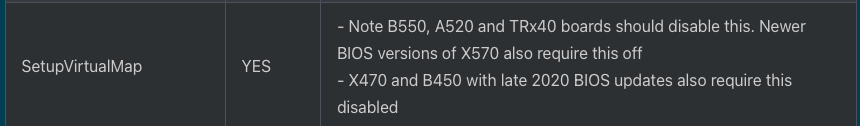

Your X570 MB may need SetupVirtualMap disabled.
