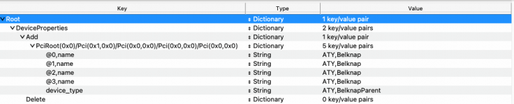

This is what the RX 6800 DeviceProperties look like when viewed in ProperTree.
The zipped plist attached below contains these same settings.
Obviously you would need to use the Device Path/Address for your RX 6800, not rely on the one shown here.
The Device Path for your GPU can be obtained from the Hackintool > PCIe tab.
