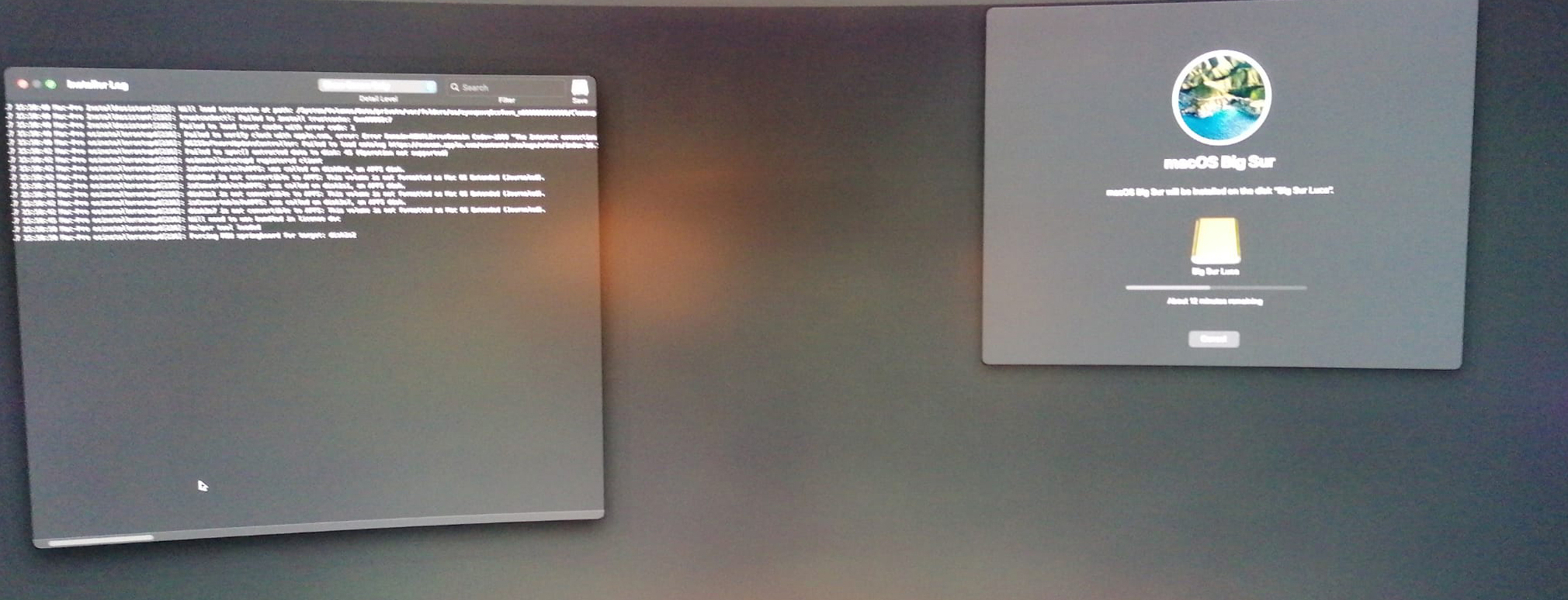

I am trying to install BIG SUR on a Gigabyte TRX40 AORUS PRO WIFI (rev. 1.0) Threadripper 3960X
The installation starts but at about "12 min left until completion" the screen freezes and I have to aboard the installation.
The last entry in the DEBUG File is the "EXITBS:START" Error.

The Screen freezes while the installation shows "about 12 minutes remaining".
I also did let the PC "sit" for about an hour, hoping that maybe the installation goes through and it is just the GPU that freezes, but so far, after restarting, there is no valid macOS on the harddrive, just the installation files were copied onto it.
