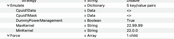

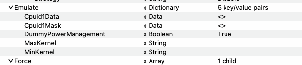

Kernel > Emulate section:
You have set MaxKernel and MinKernel in the Emulate section of your config, this is not correct. These two entries should be blank/empty.
Screenshot 2024-01-09 at 19.56.49.png Populated MaxKernel & MinKernel entries - incorrect option
Screenshot 2024-01-09 at 19.58.24.png Empty/Blank MaxKernel & MinKernel entries - correct option.
