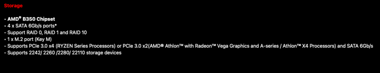

The M.2 NVMe is definitely a limiting factor, as the 120Gb drive probably has a low end controller, that limits throughput. your will normally find that the larger capacity drives have the better controllers, i.e. 1TB and above.
Before you go buying the latest and greatest M.2 drive, check that your B350 motherboard can support it. As the PCIe 3.0 NVMe connectors on your motherboard may be limited due to the older chipset it uses, compared say to a B550 or B650 motherboard.
Screenshot 2024-12-06 at 20.05.08.png Storage configuration for your MSI B350 board.
