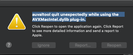

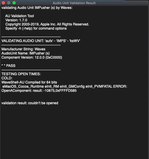

Whats up guys, running into a problem it seems for AMD cpus when it comes to wave plugins on Logic Pro x and having them crash the AU- (Audio Units) Validation test for them to work in the daw. So i spent a long time with waves tech support today to find out that its not all waves plugins but a certain set of them that do this. which would make since that about 75 percent of my plugins worked and passed the test but all the others didn't and had the same reasons for failing. As for the list of said plugins that will crash because of this problem, i don't know fully other than the ones that i have in my own personal library.
I uploaded two pictures of the problem that seems to keep happening with them. Either it completes the test and says that it failed becuase of show reasons. or it just flat out crashes the test.

It's possible that it uses Intel only instructions similar to other applications. The second image somewhat confirms this showing "AVXMacIntel.dylib"
