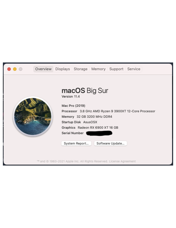

  • About This Mac now displays the correct AMD Processor info done via RestrictEvents,

Note 3 - If you are using a 6 or Less Core Ryzen then go into the Config,plist and under PlatformInfo->Generic Change the ProcessorType from 0 to 1537, This will list your CPU info correctly inside About This Mac.
