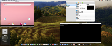

Everything works except wireless/bluetooth. I had to inject patched dsdt in order to boot with bios 1807. It may or may not work with older bios versions. I couldn't test it myself since I couldn't downgrade to an older bios even with flashback option.
Some notes:
  • This includes
    PP,PP_WorkLoadPolicyMask = 1
    whatevergreen option to fix coil whine issue in general desktop usage. It may cause lower benchmark scores.
  • DRM works
  • Sleep/usb wake works
  • Docker/android emu works with virtualbox. Though i'd never use android with vbox. Its painfully slow bc of no 3D acceleration. Docker is absolutely fine. Just ssh into your linux box.
  • Works with BIOS 1807
  • I've used fully mapped USB kext that I generated when I was using older bios, it seems to work fine. Your milage may vary.
  • Uses OpenCore 0.9.7
