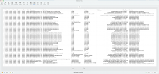

  3. One that you might need to look at is the SSDT-Bridge.aml table. This was created because the discrete GPU had a missing name in the IOReg Path for the device. This SSDT fixes this issue, by replacing the 'pic-bridge' entry in the IOReg Path with 'BRG0'. It does this for all associated components of the dGPU. The Hackintool > PCIe Devices tab below shows this name change
    1. Screenshot 2026-02-22 at 18.11.00.png Screenshot 2026-02-22 at 18.04.49.png
    2. The top 4 x entries in the Hackintool screenshot above are all related to the dGPU. 3 x entries have the BRG0 name fix applied.
    3. The 2nd screenshot shows the RX 5700 XT in System Information > Graphics/Displays, just for clarification.
