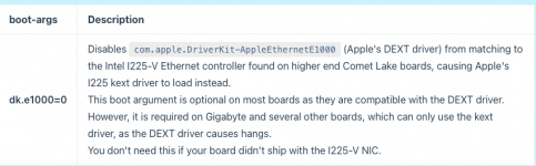

Only thing not working is the I225-V 2.5Gb ethernet...
Thanks
2,348
Good to hear it worked,
The Intel i225-V controller not working is a fairly common problem.
I added the Kernel > Patch necessary for the Intel i225-V to the config.plist, but it may also need the boot argument shown below.
The alternative to dk.e1000=0 for macOSMonterey is e1000=0. You might need to try both to see if either help.
