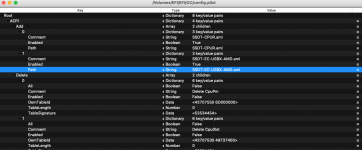

The SSDT-EC-USBX-AMD.aml goes in the Open Core/ACPI Folder and must be set in the config.plist to enable it in Open Core. I use Propertree to run the OC Snapshot function as it does it automatically instead of a manual edit.
**Remove any other USB fixes you may have in your EFi like USBInjectall.kext, GenericXHCI.kext, USBMapping.kext etc...

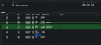

4. Reboot and check for stability. Open Hackintool and select USB tab. Next open IOARegistry Explorer and scroll down to the PTXH or XHCO sections. Plug in a USB 2.0 drive into one of your Motherboard (back panel) ports and check to find it in IoReg explorer, it will appear as USB 2.0 device in Green text. This means it is live and mounted. Now check Hackintool and check that the locations and functions are the same.
5. Using Hackintool adjust the port type to USB 2.0 if it isn't already. The small up down arrows on the right side of the USB2 label in Hackintool can be used to set correct values. Set Bluetooth or other Internal Hubs to "Internal" as shown.

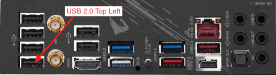

Note: It is a good idea and most intel guides recommend drawing a map of the front and back panels while doing this mapping. If you can find a picture of yours download it and print if possible and take notes like below. This comes in handy if you want to customize the names of these ports later.
