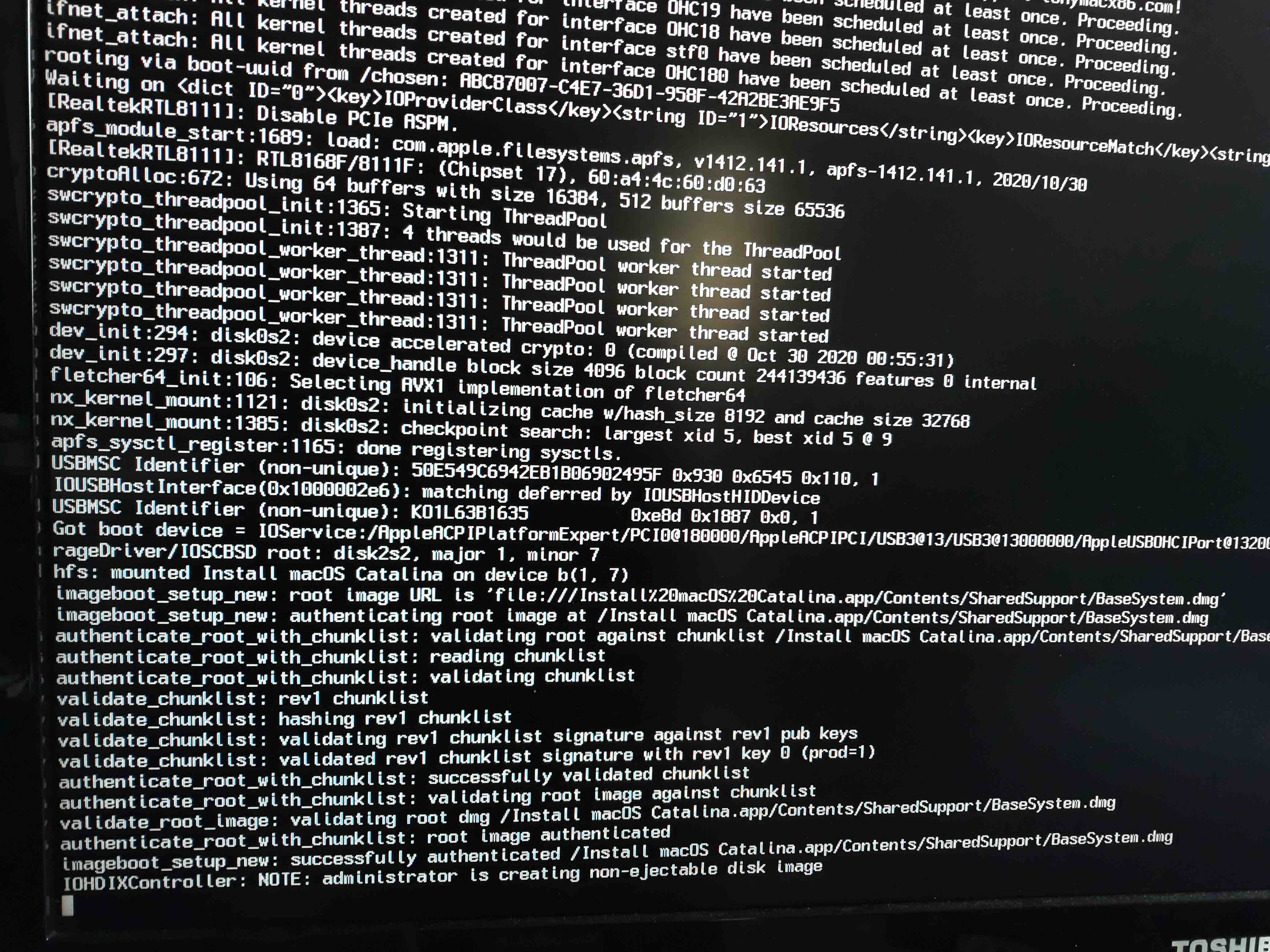

hi guys, after some searching I found a EFI for my setup but its not the latestOpenCore, I think its 0.6.0 and I'm now stuck at NOTE: administrator is creating non-ejectable disk image. I'm hoping that someone can help me on this. I've attached photo and EFI
