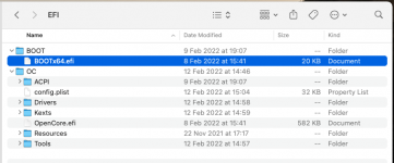

xavierbaez
Feb 13, 2022
29
Okay it worked with ProperTree
However I got a new problem:
“OpenCore OC:Driver EFI/BOOT/BOOTx64.efi cannot be found”
I’m pretty sure that file is there.
Has anybody seen this problem before?
2,382
Is the BOOTx64.efi file in the correct location within the EFI folder structure, as shown below?
The /EFI/BOOT folder, which contains the BOOTx64.efi file should be outside the /EFI/OC folder, but within the main EFI folder.
