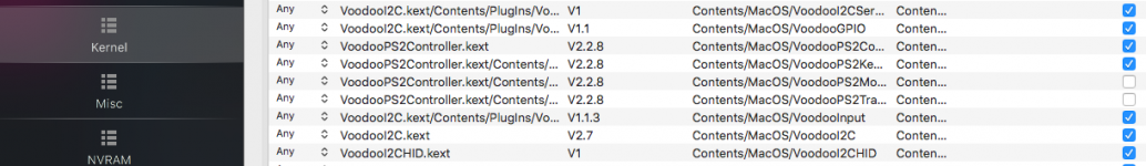

For the trackpad, this is normally how I set mine up.
Also make sure you have a SSDT-GPIO enabled.
I set it up like yours, the pointer is still corrupted looking. Something I did notice, if I update the Voodoo2C.kext the trackpad lags bad, if I leave the previous version, it works as it should, just has a corrupted pointer that is hard to see and figure where the point of it is. I plugged in a mouse and the pointer stays the same so not sure what is going on.

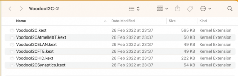

Did you discover which drive the Trackpad uses in Windows? As the VoodooI2C download contains a number of helper kexts, which work with specific Trackpads, depending on the manufacturer/driver used in Windows.
Screenshot 2022-07-23 at 17.40.50.png Contents of VoodooI2C release 2.7 folder
The VoodooI2C.kext and VoodooI2CHID.kext are normally used as a base. But only one of the other four kexts should be used. Hence the need to know which Trackpad your laptop uses.
Are you using the SSDT-GPIO.aml with your laptop? As this SSDT is used for creating a stub to allow VoodooI2C to connect onto.
Have a read of this guide on how to create an SSDT-GPIO.aml table for your laptop.
View attachment 6683 Contents of VoodooI2C release 2.7 folder
