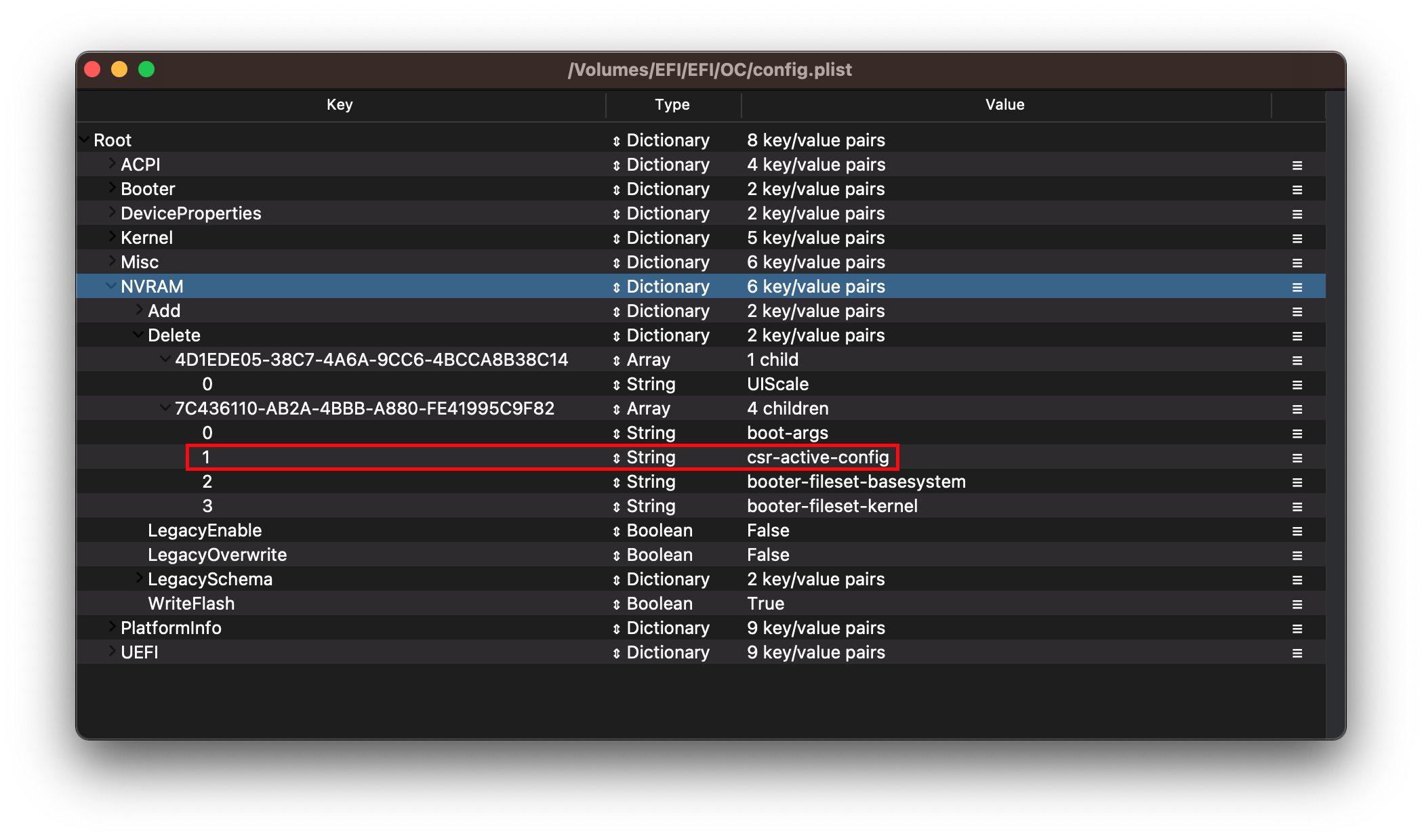

in my config.plist
csr-active-config <FF0F0000>
Is it correct? I look dortania guide
2,186
Yes you need to add it in Delete also,
NVRAM -> Delete -> 7C436110-AB2A-4BBB-A880-FE41995C9F82 -> csr-active-config
Pehem17260
48
Ihve the twice but I've a new message at boot OpenCore
