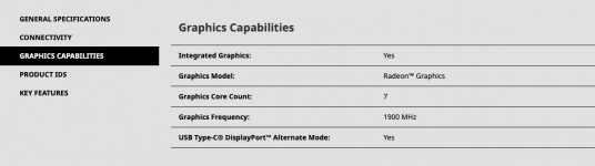

Picked it up earlier from Micro Centre!, including sticker, CPU fan and tax $92!. Why?, because NootedRed.kext has made some progress recently and I wanted my next build to be different!. In theory full acceleration in macOS should be 1900 MHz, will I see that frequency in the 'About This Mac' window?. I have a choice between a Gigabyte B450M DS3H WiFi and ASUS Prime A320I-K motherboard, the 320 has flaky Ethernet and no WiFi/BT but, does have a DP port. The 450 does have working Ethernet, WiFi and BT but, only one HDMI port!. I have attached EFI for the respective motherboards, they have the latest patches with SMBIOS set to iMacPro1,1. I also added SSDT-ALSO, SSDT-PNLF and the BrightnessKeys.kext from the NootedRed GitHub.
