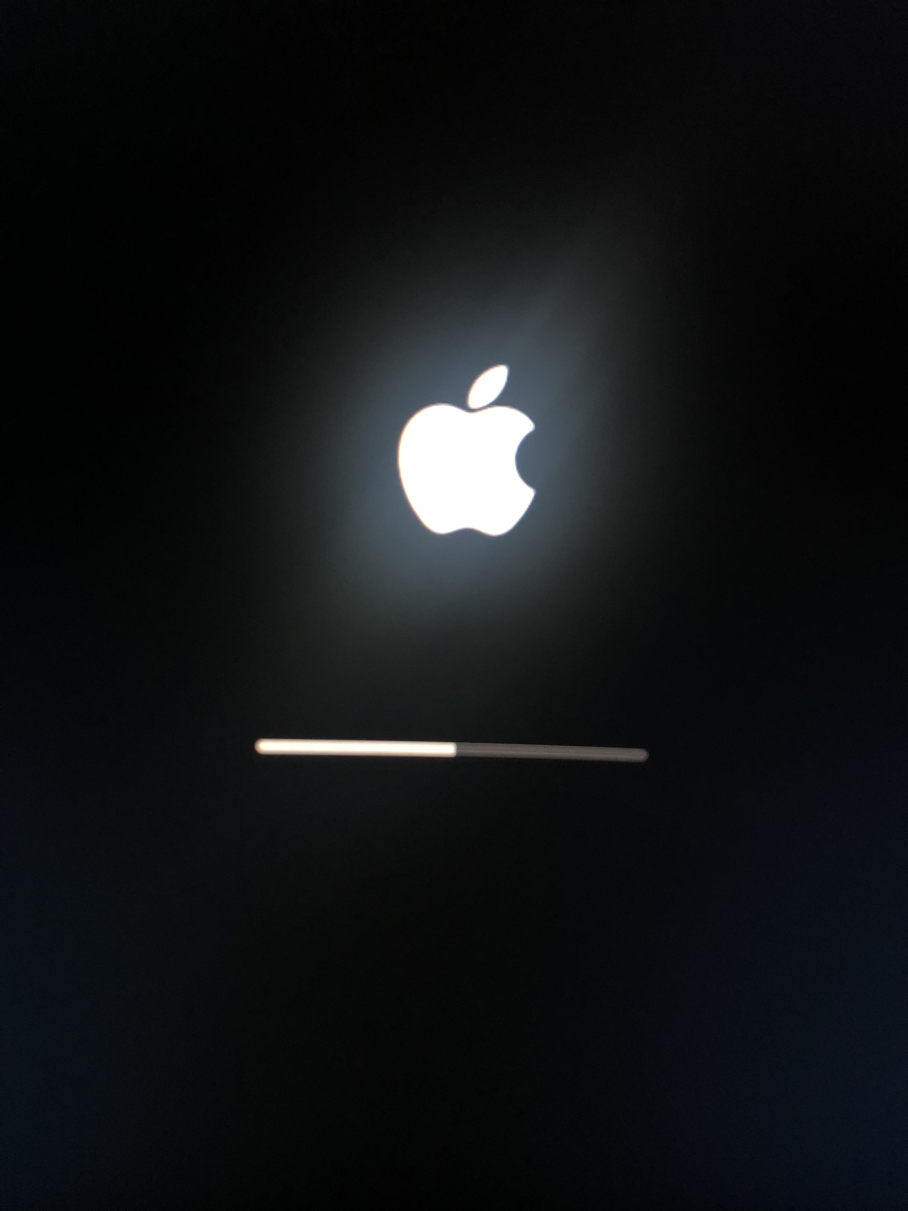

Hopefully the OS will install and you can run Monterey as you wanted. Best of luck.
Do we have to use the _MacOSX? (In EFI File)
nvm my PC is stuck on the apple loading bar
My Pc Specs:
Ryzen 7 3700X 8-core Processer
16 GB Ram
AMD: Radeon RX-6700 XT
